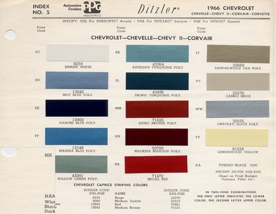

I use it in restoring old GM cars too. I use my local Car Quest PPG paint. It is a dull silver. Also, Spray cans are available from Ausley's Chevelle. You can do a GM paint chip search and for 1966 and it will show a color chip but it may or may not look good. Here is what I used in the past. Argent Silver number is there but not a chip in the attachment.
