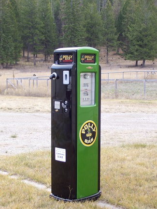

Polly is supposed to be black with green accents. Polly was bought by Wilshire. Wilshire pumps were light green with dark green bases or accents. Most original Polly and or Wilshire stations pictures I have seen have light colored pumps. Here are a couple examples.

So black with light green accents, sounds like what I had in mind.

When I painted my Bennett, I looked in Scott B and Wayne H's book and saw that Polly was black and green. I picked a green that matched the green on the decal and ad glass.

They did not originally use orange but you need to do what pleases you. If you want multiple colors or a color that was not originally used then that is what you should do. That is why there are many versions out there, other people have done that.

That PCM guide book has the original Polly paint schemes in there. Like Matt says almost all black with just a little green is original. Probably look pretty good done original paint scheme, be nice if there was a little more green in there! I'm not sure what the original green really was but the brighter green on black is pretty sharp. I've seen a much more muted green that just kind of just lays there in my opinion. If your decal isn't immediately adjacent to the green on the pump you can get away with having a slightly different green color paint on the pump. Not all Polly decals out there use the same green color.
