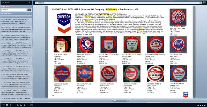

If you look at the Standard Gasoline globe from Standard Oil of California, on the globe CD, page 82, it has the same number and placement of prongs, as the suspect globe.
I'm using the 2012 version of the CD, and that is where I took my reference picture from, and it does not agree with the globe of subject. For me it was page 57.
BTW, FWIW, it was not my intention to call out this seller, they probably have no idea whether or not this is authentic.
