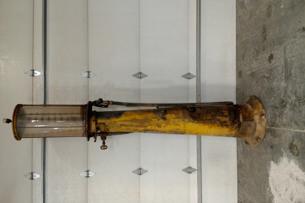

Thanks again for the help. So I got it today. We took most of the wall front off to get it out all went real good got home in good shape. Here are some pictures of it. I have no idea what model it is. So any help would be great or pictures of one at a station so I can see what the top would look like. The sheet metal is steel and all one peace that is a first for me lol the one side looks like the bog metal peace was cut out at some time. Any way this one has me stumped. Thanks
