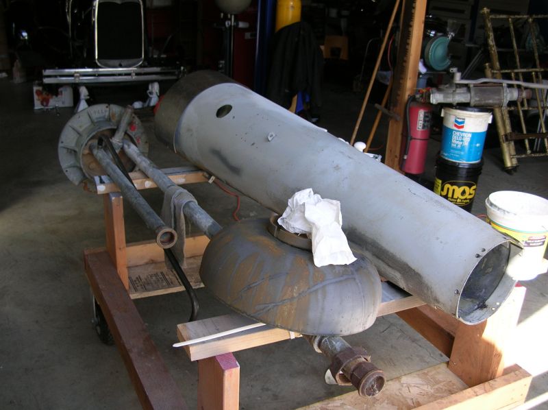

Does this help? My 515 has 3 all-thread bolts that are approximately 5 1/2’ long.

Boiler88.
Thanks for posting a picture of the Wayne 515 while it was being restored in my work shop in Queen Valley Arizona,
Bruce.

So are those rods in Bruce’s restoration from the factory and only in certain 515 models? Because as Jerry mentioned, the skins are what hold the pump up.
Another question arose while I was tinkering with this pump. Bolting the skins to the upper and lower base is no problem, but how do you bolt the skins together along the two vertical seams? Once the skins are on, you cant reach 5’ up from the bottom and hold a nut??? Most pumps I have dealt with have the little tabs on the outside that you just bolt together. This pump has holes drilled through one skin and into the other skins recessed holes. (This one is tough to explain, unless you know what I’m talking about).
And here’s the two pipes in Jacks literature that I asked about earlier (red arrows). Do they provide any structural stabilization. I heard they do not. The pipe on the left sure looks like the one in Bruce’s restoration. I can definitely tell you that there are NOT three mounting holes cast into the base like a 615, there is only one (and none broke off). Thoughts???

The one on the left is a support rod. The one I have has three of them and they are half inch diameter my best guess. The one on the right looks like the electrical conduit judging by the connector on the bottom.

Wow. All excellent excellent info. My skin does have the flat bar welded up the entire length. I guess I didn’t notice the holes were threaded (mine are pretty rusty, I’ll have to run a tap through).
As for the support rod(s), I don’t see anywhere where they would attach, except for one of them. I’m guessing there was a design change from one to three at some point. My base looks exactly like 42Packard’s, with one hole for a rod.
