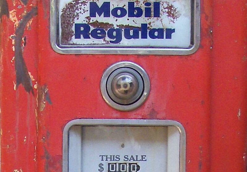

Working on a Wayne 70 gas pump. I installed the chrome bezels on both the front and back doors. When I shut the doors there is a fairly large gap between the bezel and sight glass. Was there another chrome piece that went on the sight glass it’s self or was there some sort of gasket used to take up this gap?

There is a chrome piece that goes on the sight glass nut but even with it missing there is not a gap.

This is what it looks like with the sight glass nut chrome missing.

Yes, that is exactly what mine looks like as well. Your saying there is a chrome piece that goes on the sight glass nut also?

Yes, it fits over the nut. It looks the same as the nut.

I just happen to be working on one.[Linked Image]

Thank you for the information and pictures. I see Gas Pump Heaven carries them.
