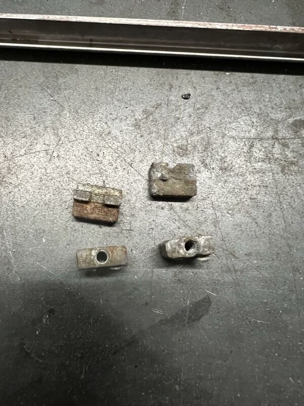

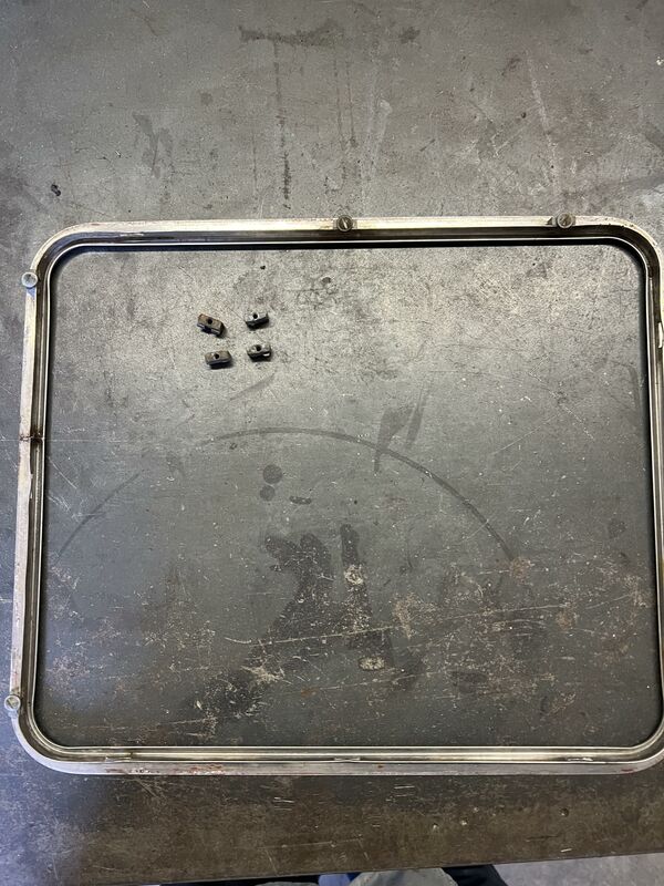

Hi all,
I'm working on a Wayne 70 and the stainless window trim has several of the retainer inserts dislodged (off). How do you guys reattach these pieces?
Thanks for your time.
Ed

Not ideal, but if you abrade the surfaces and pot it in JB Weld (where it goes up the sides, not just the face), would probably work. I haven't done this on a 70 but done similiar on other pumps as a last resort.

I use JB weld also, just don't get too aggressive when you tighten the screw. Richard

GPH sells a replacement with threaded rods. They work well Paul www.severngaspumps.com
