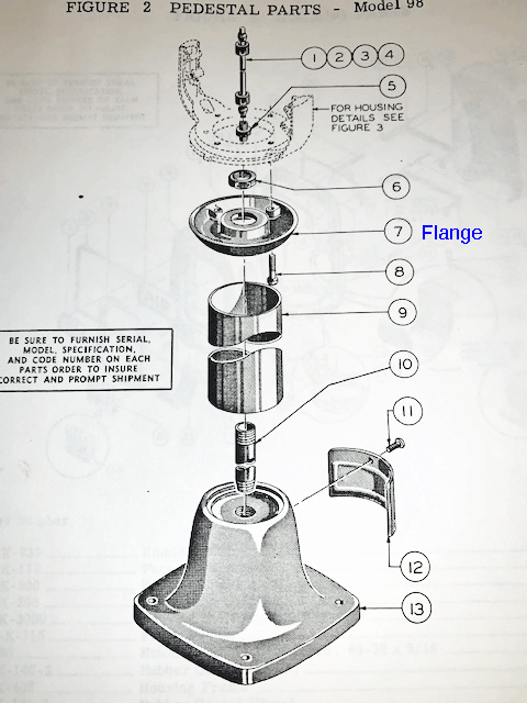

I have the flange yes. I can get better pictures if needed. I thought that the electrical pipe looked odd but I wasn't 100% sure about it because I had seen 1 other with the same pipe in it. Must have been a coincidence. This is the picture of the flange I have, air with water. I can go out to the shop and take a picture of my upper and lower nuts if its needed. I would need a few minutes to take them and upload them to the computer though.

At 75 years of so old there is no telling what someone did to it. I 100% trust Ron and his knowledge. By the looks of the diagram of Ron's I'm guessing the nut for the bottom in the picture isn't supposed to even be used? I can get the pipe size I need and a nut for the top, but have no idea about this thing.

There never was a nut on the bottom. The pipe threads into the base only. What it appears to me is that the thing attached to the pipe is what is left of a broken base? If the pipe is 1" and this thing on the bottom is wider, why not remove this broken piece to expose the 1" threads, then screw it into a good base? I'm thinking that this should be very simple to fix? Paul www.severngaspumps.com

You should have a base that looks something like this , as already mentioned unfortunately the chunk of metal on the end of your pipe is broken out of the base

It makes sense. I thought it looked like a weld was broken from it or that it broke off of something. I cant imagine the force needed to do such damage. Thanks for the photo. I attempted to look at my fathers old restored 98 model but he had it so close to a concrete foundation that I couldn't get my head low enough to see anything. I dang sure wasn't going to stick my hand in what appeared to be a black widow web to find out either.
