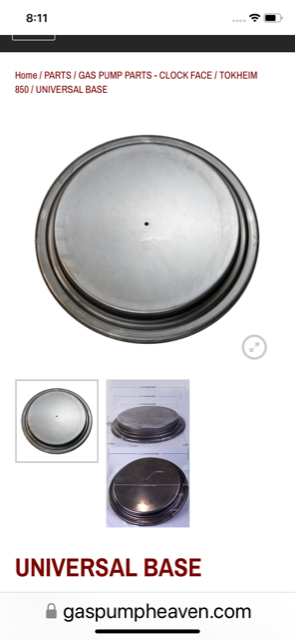

I bought this a while back with a car from a guy. I posted pics on a FB page and I’m told it’s a Boyle Dayton.
I see Gas pull heaven sells a universal base, skins, top ect so I can restore it
I am a novice to these. My pump is missing two of the hexigon screw on ends to the pipes. Where can I source them and how does this attach to the “ Universal base”?
Looking for any advise thanks
