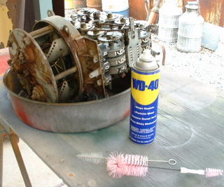

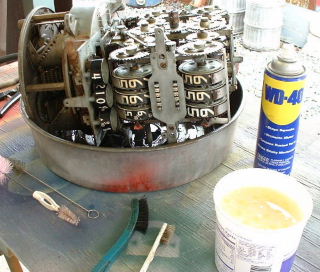

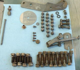

So while your skins are in the powder coaters shop gitting blasted and coated for 300.00 (can't beat that), I remove the computer , for cleaning , take all the small stuff and put them in Real Lemon juice with a lid over night , wire brush and drill motor the frame as good as possible, wd-40 the computer, and clean the dials with a plastic brush and land cleaner, useing a tooth brush and baby bottle brush in and all around the computer un til its free, and moveing very well, a light wire brushing on the small stuff that soaked in Real Lemon juice over night and your ready when your skins come home, very one has different ways to do it, but t-way is right about the body work,I have all the holes filled at the powder coaters, the body work I do the best I can , a few dings won't hurt it much it gives it character
