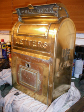

I did a 1920's mailbox with brasso. It took forever.Afterwards I wiped it with Meguairs NGT quick detailer. That stuff is awesome. It will make just waxed paint shine even more and seems to keep dust from sticking as much.
Check this link
http://www.doityourself.com/stry/brass
Or contact the real pros.
http://si.edu/mci/
