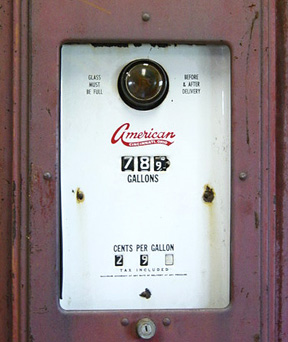

Everyone:
Here is a shot of the face on my latest acquisition - an American 902. It was specifically produced as a farm pump. The gallon wheels are at the top of the faceplate (instead of the center) and there aren't even any other wheels inside (other than the 'cents/gallon wheels') - no VR computing unit attached to the head either.
I have to believe that other manufactures did the same thing. As soon as Jack logs on, I'm sure he can shed more light on the subject.
Later . . .
Jim
[This message has been edited by T-way (edited 09-30-2003).]

Posts: 6,772
Posts: 6,772
T-Way,
Your pump was more likely produced for a trucking, bus,or construction co. to use in their own yard to fuel their own equipment. Those companies wouldn't have any need for a computing pump, but knowing how many gallons they were using was essential.Very few pumps were bought new by farmers.Ask every farmer you know if they ever bought a new pump. Almost all of them will say they haven't. The exceptions would be gasboy pumps, and the tank mounted pumps they use now.
Bob

Bob:
You are probably right. I never thought about a bus depot or a trucking company.
I was told by the 'picker' I bought this pump from, that it came off a farm. He said the farmer had owned it since new. It has NEVER been repainted. There was still a little 'shine' to the original red paint underneath the I.D. tag when I pulled the tag off.
I supposed it could be one of those pumps that was originally 'loaned' to the farmer by the gas distributor and never retrieved.
Oh well - I like it and plan on converting it to a regular sale/gallons/price VR unit when I re-do it. I'll probably keep the VR unit and the one faceplate from it as a curiosity. Maybe turn them into a table lamp?
Later . . .
Jim
