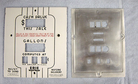

41Again:
Correct-o-mundo!
Clockface versions have the glass in front of (outside) the porcelain faceplates. Computer/VR versions have the glass mounted between the VR unit and the procelain faceplates.
As I mentioned previously, I'll post shots of the VR version faceplate/glass/stamped holder mounting arrangement tomorrow.

Sorry for the delay - I forgot my 'Travel Drive' yesterday so I didn't have the photos. Anyway, here ya go. This is a shot of the faceplate installed on the pump. Now here is a shot of the assembly off of the pump. If you look closely, you can see the glass sitting on the backing plate/retainer. Notice the 'decimal point' on the backing plate in the 'price' area. You have to hold all three pieces together while you start the faceplate retaining screws. Otherwise, the glass falls out and then you have a mess. LOL  Later . . . Jim Always buying Ethyl Globes, Ethyl Single Lenses & Misc Ethyl Items.
