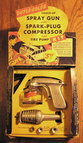

Here is a very cool paint spray setup from my collection. Don't need no stinkin' compressor or turbine. Just put the special fitting in place of a spark plug on your car and spray away. You can't beat that $5.95 price either.

......just when I thought I'd seen everything.LOL. Cool stuff Jim.
