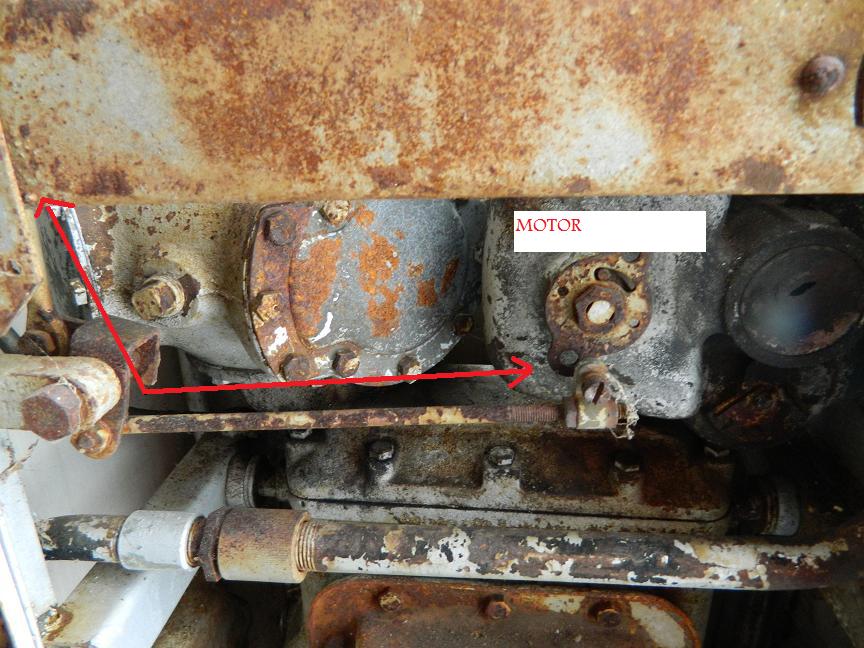

Just wondering what this part is and its function. Thanks, Chad.

It originally was the linkage to start the pump motor. Since the electric motor is gone, it is no longer needed. Paul www.severngaspumps.com

It also is connected to the nozzle lever. How did it start the motor?

Remove nozzle, Flip lever up & it started the motor.

Dick's rite. LOL. Sometimes questions are asked here that are way too complicated....all this stuff was mechanical. It is very basic and only takes a little common sense to figure out. Paul www.severngaspumps.com

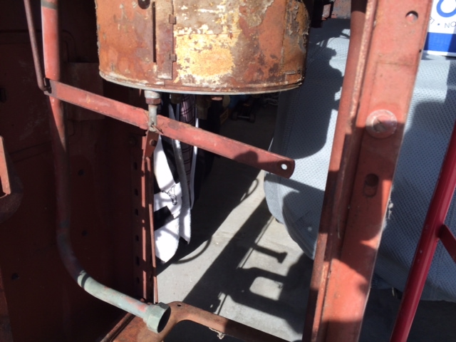

Not exactly the same as yours, but the same principal.
When you turn the nozzle lever, the linkage moves the switch actuator on the motor to the "on" position.
