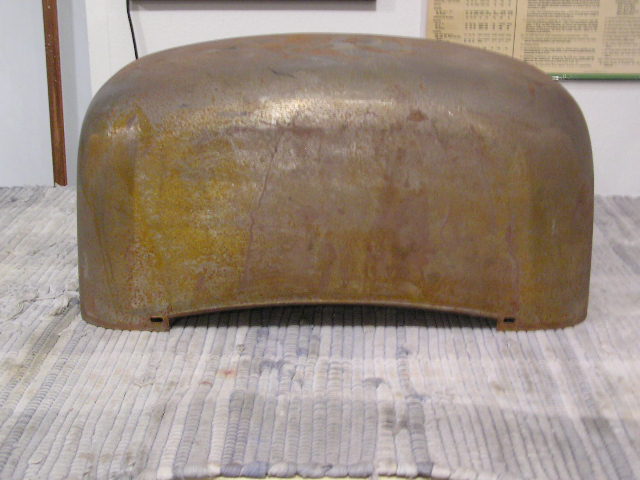

I recently picked up on original M & S 80 tall top that is solid (same height as script top) . Does not have script cut out or hole for sight glass. Has anyone picked up one of these in the past, and is it possible to have lettering cut out for script top? If so, any recommendations on the best process. Thanks,

I've never heard of anyone doing it, but I have to think it could be done? You wouldn't have the little mounting posts on the inside though.

I think it would be tuff to do unless you had some form of tracer mill. I have had a couple of these tops over the years.

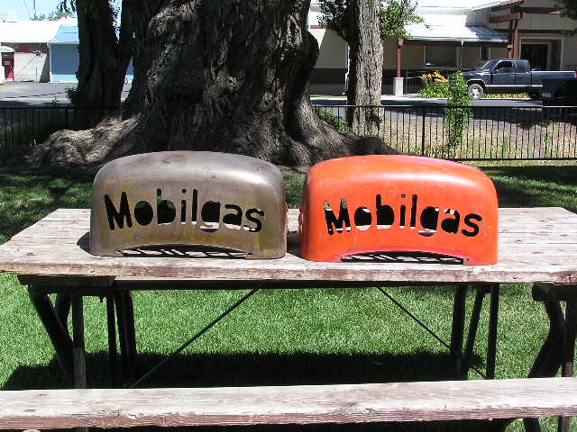

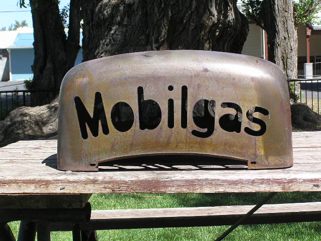

Update on my M & S 80 Blank Top. Thanks to Husky Bob for allowing me to borrow his top as a pattern. Was able to locate a 3D laser cutter. Photos of before, after and comparison to original.

Looks very good!

Now the threaded metal studs need to be applied.

That is the next step. smile

Nice job !

Sure looks good Have you tried the inserts yet?

Looking awesome.
