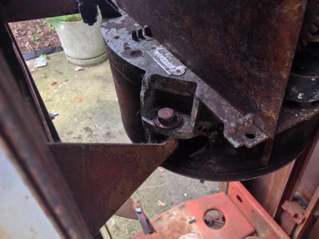

Leave the pump and other guts out not important to the unit anymore. I have a LRP. There's three brackets to mount the unit to depending on how your looking at it there's two on the right and one on the left in the back or front depends on where your looking at it from.

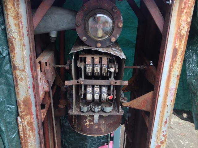

I want to know how the install the Site glass spinners and site glass bezel. Do they get hooked up to the veeder root?
Posts: 8,818 Likes: 2
Posts: 8,818 Likes: 2 |
The sight glass manifold attaches to the top brace and not the VR. Post pictures of your parts as on some 39's the sight glass manifold attaches directly to the top brace and on some brackets are utilized.

Site Glass Manifold?? What does that look like??

Do they get hooked up to the veeder root? Not on mine, mine bolts to the inside top
The sight glass manifold is the complete assembly that the spinners, sight glass and retaining ring attach to. As seen in this photograph, above the VR.
