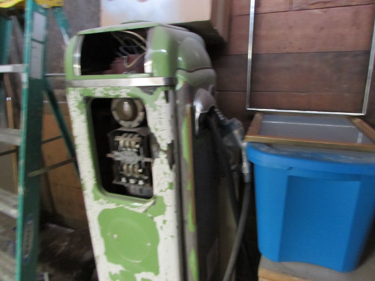

I am new to this hobby but have got my first pump lined up. I have some information and photos and would ask for some knowledge on what I have.

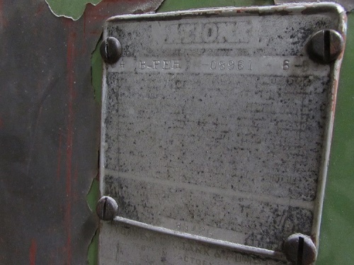

It is a National and I believe it was labeled as a Flying A. Here are some numbers on the tag.
B-PEH - 08961 and I believe a date code of 6-53

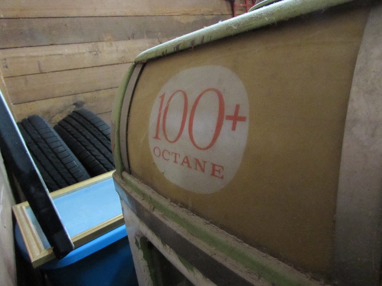

On the bottom of the tag are the numbers 83426. I have found some photos of similar pumps but nothing with the 100+ OCTANE.
Also, is this a pump that could be changed to a different brand such as Shell or Sinclair if I wanted without hurting value. I am actually wanting to restore it as a display in my shop and have no intentions on selling it. I just would like to know some back ground information on it.
One last thing, would this pump have a globe and would it be a 13.5 inch or bigger. Please excuse my lack of knowledge. I am trying to learn as I go here

National A62. It's a porcelain pump. Use some paint stripper to get the paint off and you may have a really nice, original pump you can display as-is. They usually didn't have globes.

If the ad glass is original to the pump? Then based on Tidewater Flying A advertising, the pump was in use until approx 1960... (Tidewater used that 100+ Octane design/logo from the later part of '58 to 1960)

You are all wrong. First this pump is basically the Tokheim 300 with a different top, and the stainless trim & the ID tag says National. Tokheim acquired National, they stopped making the National pumps where the letter in the ID tag was first, then the number (example A-38). Tokheim changed the model numbers to be number first, then the letter. Take a good look at the ID tag above, this pump is a 64-B. The 64 had the 17' hose, where the 62 had a 12" and the 66 had a 14.'

I beg to differ. The pump is a tokheim 39 basically except for the ad glass top. It is a national a62. The tokheim 300 platform is the basis for the national 360. Someone could have swapped out id tags at one point. It would look good with the paint stripped off to original porcelain but it is your pump and do as you please with it.

I would say you are right Phil about the ID tag being changed as the mounting screws do not look like factory twist rivets or screws. Can not tell from the pictures but the top looks to have the globe mounting platform on it. Have seen a lot of these ad glass top pumps in the past but only 3 or 4 of them with the globe mount platform.

Good eyes Don! It does look like it has a globe blank...I've only seen one or two of those myself. Phil is 100% right on the platform...Tokheim 39...not 300.

I do appreciate all of the knowledge I have gained here. Yes from what I see, there is a provision on the top for a globe whether it was original or not I do not know. Secondly, I do agree that the screws holding the ID tag do not look original.

Try removing the top left screw of the id plate. You may see a 64 there. I have seen a A63 which was the same pump as a 62. They may have made slight changes in the pump and then changed the production number. Richard

The ID tag states 64-B-PEH.

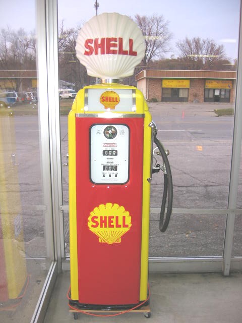

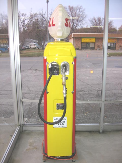

Looks like a National 64 to me. Here is mine with the original globe setup.
