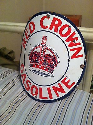

A couple of weeks ago I purchased a curved pump plate on EBay. I was looking at it and the porcelain was flatter than normal and it had small vertical cracks like it was rolled after the porcelain glaze was applied and baked. I have sent a question to the person asking them if this was original - and get no reply. Did I get scammed? Has any one have an original with these same cracks?

Scammed
Bob, Red Crown never made a pump plate curved or flat. What was the ebay item number? If the listing leads someone to believe it's original you can try to open a case against the seller.

Anthony...I'm guessing the OP is talking about the Standard Red Crown rectangular pp in the 12X15 size....I'm sure a repro of this sign would be a prime item for rolling and aging to fool unsuspecting/uneducated buyers.

The 11 3/4" - 12" round Red Crown signs are fantasy pieces. Standard used decals back then.
The Red Crown pumps signs were rectangular, and flat.

there are 2 on sold auctions from the same seller 261.29 & 133.06- don't see anything in either listing claiming original or reproduction... cool
http://www.ebay.com/itm/Red-Crown-Gas-Porcelain-Sign-Curved-/181594692400

Until Bob mentioned it and Randy posted the pic I didn't even think about the repro 12" rounds. I think sometimes when you've been in the hobby for a few years, you take for granted the knowledge you gain. When the OP said he purchased a Red Crown pp the thought didn't even cross my mind he was likely referring to one of these rounds. The only original Red Crown pp I know of is the rectangular one, so I made the assumption this is what the poster had bought.
When I got seriously involved in the hobby 8+ years ago, 95% of these signs were still pretty much sold for what they are, fantasy signs used for decorating walls in "mancaves" or shops. With the explosion of the hobby in the last few years and the escalating prices, they became the prime bait for ripping off newcomers and uneducated buyers. Roll them, shoot them up a little, a few chips and a salt bath, they go from $20 signs to $200 signs to the unknowing buyer. I shake my head every time I see one of the Marathon running man 12" rounds sell for hundreds of dollars. I guess my purpose for this post was this kind of made me step back and realize how fortunate I was to come into the hobby just previous to the major rip-off explosion. Knowledge is king for sure.....if you're new to the hobby or unsure of what you're buying, do the research first, purchase later......unless it's a screaming deal and you don't mind taking a gamble, lol!

This seller is making a living ripping off buyers with phony rolled and artificially aged signs. Check out his ended auctions.
You might get a full refund if you claim the sign wasn't as described. You say it has small vertical cracks in the porcelain. Those don't show in the photos. That is a real clue the sign was rolled. As far as I can see in his ended auctions all of the signs are phony, bogus, artificially aged to deceive. I even wonder if there are shill bids.
