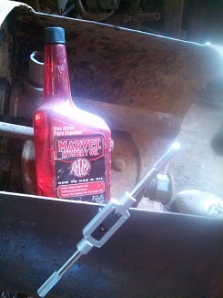

Use lots of oil. You may have to replace the die with a better quality one, like from Ace hardware or somewhere of that caliber. If you have never used a die before, once you get it started straight go about a half turn at a time and back up each time to break the chips. Advice much appreciated. When I returned from Iraq I purchased a 25 year old German car as a daily driver; about an hour each way to work. So have no doubt I have a lot of experience with tap and die usage. But my 'good' set is an all metric set I picked up in the middle east. So just purchasing a 1/4-20 die won't fit it. Will see what Ace has to offer though. Just don't think I will use the SAE set that often. 25yr old German car and daily driver don't go together in the same sentence LOL. Looking forward to the outcome. Cool pump!

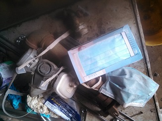

So today got back on hitting the rough spots with the wire brush grinder. Amamzing how much a few minutes can make.
Safety note, be sure to wear some sort of mask when using a grinder on this type of stuff. Always assume some stuff this old has lead based paint on it. I switch between simple masks from Walgreens and the 3M respirator depending on the job.
michael

Started making the lower doors today. The bolt holes are 5/16th btw, a little oil and tap work had them working great again. M
