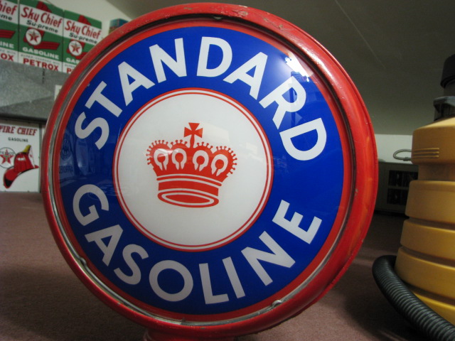

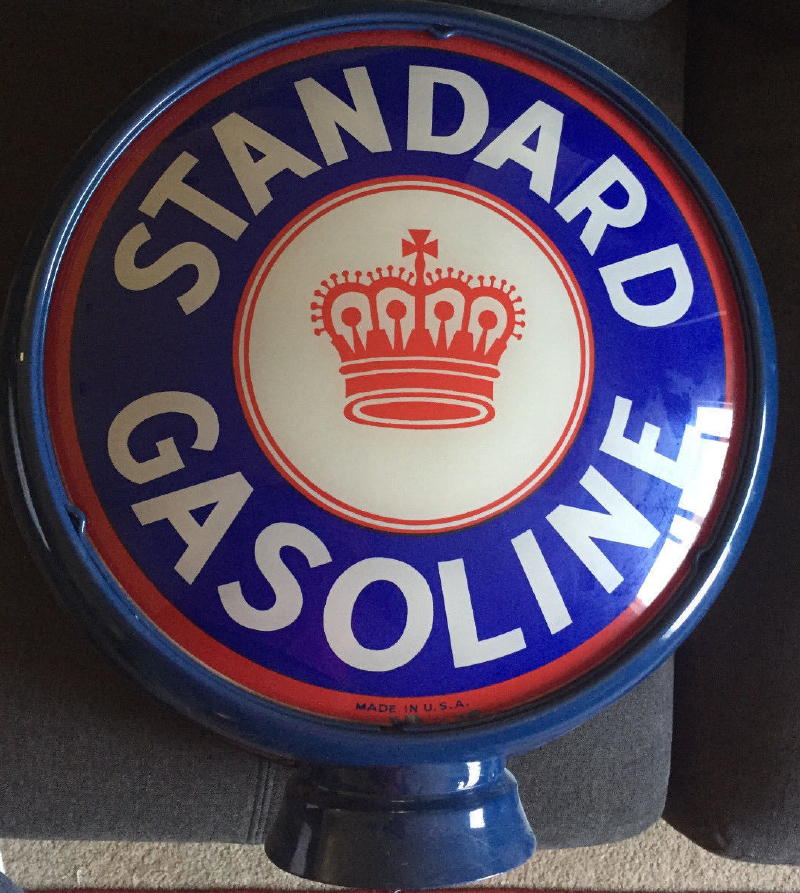

On the service I would have thought for sure this was a legit globe. (1st & 2nd picture)
And no white haze on backside of lens. (something I'm still learning about)
http://www.ebay.com/itm/Original-Old-Sta...s-/232291853125

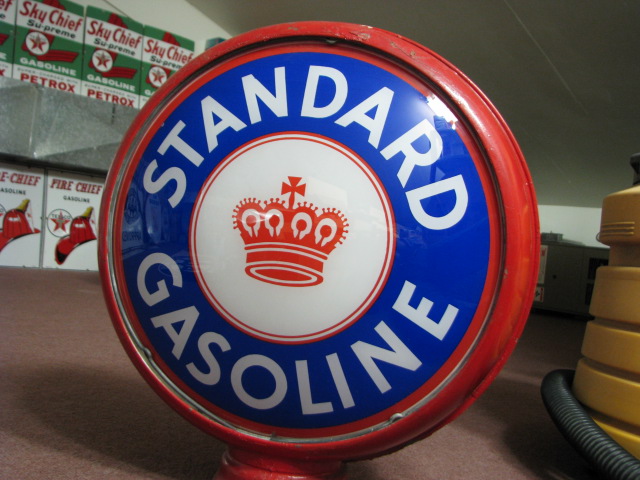

But if you look closely and compare it to the picture from the globe CD (3rd picture), I guess it's not. Count the number of little prongs on the crown. And the shape of the opening for your head in the crown.
Any thoughts??

Hmmmm....?? Another clue just hit me, the inside of the frame is not painted!!
Is that a legitimate issue on original frames? Was the inside always painted??
compare the "O" in gasoline
there is definitely a difference
good eye Steve .. ... cool

I don't know....I think the globe is made up of original lenses in a repro body. I don't remember ever seeing known repros of this lens design. The back of the lenses look correct, as well as some slight honest wear showing in the lower red band area in one of the head on photos. Another thing we must keep in mind is there is always the possibility of multiple lens manufacturers, so differences are possible in originals.
I will say there are repro 15" lenses that I was told were made in Canada in the 1980's that do have the "original like" fritty, sandy feeling backs. Very well done in the original process, unlike the the white backs we see today. I have a repro 15" Texaco lens by this manufacturer.

Um... quick clue... "Made in USA" on the lens... not legit as far as I'm aware on supposed 15" early globes. I started noticing these a while back. Most of the time original markings are not seen or are 'Reg' marks or the like vs Made in USA.
I wouldn't expect 'Made in the USA' to particularly be on any vintage globe glass in the visible era. When it was used back then it was on products like knives, razors, etc. Typically this marking is on such 'consumer' items. It didn't become more widespread until the 1960s with the influx of cheap Japanese merchandise. Remember we use to call all that stuff 'Japanese junk' and would look for made in the USA. Then later it became a whole labeling campaign promoted by the federal government.
As far as the metal surround, the reproductions tend to have a slightly more silver/whiteness to the metal sheen due to more zinc in the metals being reprocessed by China and the like. The older NOS tend to look more like gunmetal grey overall in my experience, slightly duller on visual inspection.

Also, look at the positioning of the crown.. it appears high rather than centered and the outer red is much thinner. Dan Morphy auction for original one of these. Compare.
