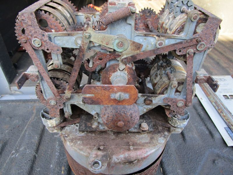

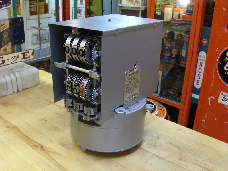

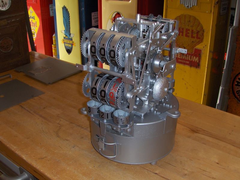

The computer that as in it was incorrect. It was a 12 inch and it needed a 10 3/4 inch. This is an odd size and was only used in Tokheim 36 and 36ADC, so not an easy one to find. A oldgas member helped me out and got one from a 36 that was getting parted out. It was badly rusted. I had to carefully cut it apart and save the 10 3/4 specific parts. I then sacrificed a early 12 inch side totalizer computer for parts. I sent all the parts along with an N.O.S. totalizer to Joe Yocom. He did his wonders and it looks great. It is connected to the reset handle and resets with a ring of the bell. Thank you Joe.
