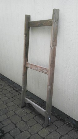

Every pump guy I know has one of these but I thought I would share my latest design especially for people new to the pump hobby.
These make loading a pump in a pickup so much easier. My old one was getting ragged and I had been thinking on improving the design. The single best feature is the notch to catch the tail gate. If you ever tried loading a pump in the back of a pickup, as soon as you pick the pump up to tilt it in, the pump wants to chase your a$$ backwards. As you can see in the pictures it could not be any easier (unless you had your buddy do all the work...lol) There is no way I could stand there and hold the pump up with 2 fingers without the notches.
The next best addition was the wheels, after is tilted into the bed it just rolls right in. The grab handles are from a Bennett pump. All totaled, I have less than $20 into it. Bought treated lumber at Home Depot and the rest was stuff I had lying around.
I'm sure there is more refinements that could be made, share them if you got them.
Tom.

How about a drawing with dimensions and location of the notch! I like this more than mine!
tbuckles #652264 Wed Apr 06 2016 06:17 PM

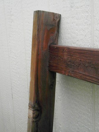

Kevin the notch will vary depending on height of tailgate.
tbuckles #652265 Wed Apr 06 2016 06:21 PM

Great idea, and hope that tail gate is strong.

John is exactly right about the notch, it depend on the height of the tail gate. I wish I was smart enough to give a mathematical calculation...but.....I just eyeballed it. Before you cut the notch get someone to help lift and try varying the angle till you find the right pivot point.

confused Maybe a couple different notches located a couple inches apart. Tallness and weight of the pump will vary, equals balance point varies. My Daddy always said: "Work smarter, not harder." wink Ed.

Good idea, I'd build one if I moved pumps around a lot. What about retractable wheels or wheels that can be added once on the ground so you could also use it as a dolly/truck cart, also.

Tom, I woke up at 3 A.M. this morning and realized that the pump was not attached to the loading rack? Won't it bounce off during your travels? Maybe a strap or two would help? I'm retired too and this is what I think about when I should be asleep. LOL! Paul www.severngaspumps.com

Why a notch? I would think a 1x2, or maybe a couple of them , across the back side would be better. It would still catch the tailgate and you wouldn't have to worry about the notches lining up.
I would think 1x2s would drag on the tailgate and bed making it harder to load.JMO

Now I woke up this morning worrying about my friend Paul not sleeping well, so I needed to make an addition.
The great thing about retirement is that I can implement design changes quickly, holddown straps it is.
Now that I got Paul sleeping better at night Craig has to bring up the tailgate thing, now I'm worrying....LOL.
This time I loaded a fully loaded pump and it still was not a strain but it did take two hands, not two fingers to pickup.
As always, there is more than one way to skin a cat, share if you got an idea.

On my old dolly, I oriented the crosspieces so that the long boards formed a small barrier on each side of the pump. That eliminated any side-to-side sliding and any need for straps (so far). I am definitely in debt to you, though, for the idea of the notch and the concept of the metal lip at the bottom. Looks like I have some work to do this weekend.
